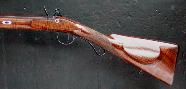

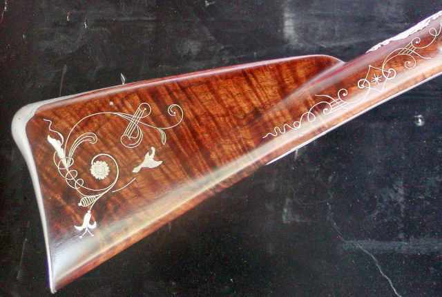

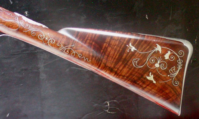

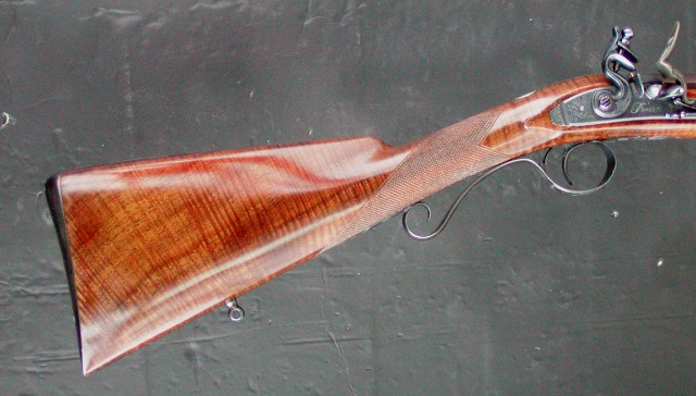

Hi,
Part of the explanation is that there was a prejudice against using woods that required stain for gunstocks.  That does not mean light colored woods were never used.  Maple, birch, sycamore, and beech all were used.  The Spanish often used cherry but if you read Espingarda Perfeyta, the authors clearly state a strong preference for walnut because of strength but also it did not require staining.  I agree that the rifle in question is stocked in some form of maple.  However, Juglans regia can have incredible curly and flame figure.  Here are two examples from my own work.
  • Posts: 17145
Re: Old World Curl
« Reply #13 on: October 23, 2025, 02:54:24 AM »
WOW Dave. I've always thought those 2 were maple. Was i ever wrong.

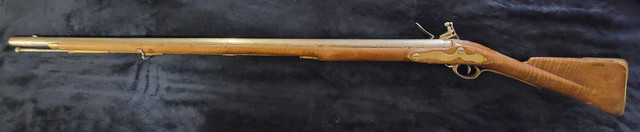

« Reply #18 on: November 02, 2025, 07:51:04 PM »
This is a curly 1777 Pattern Brown Bess.
