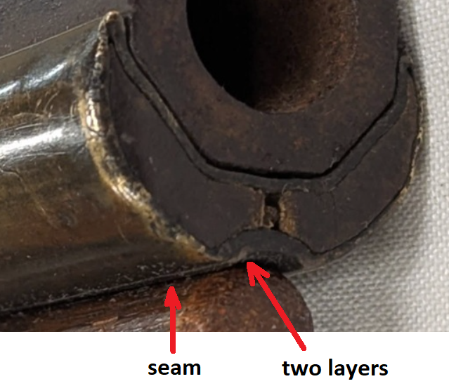

Great article and pics.  Interesting nose cap that I have not noticed before.  Appears to fully wrap the forestock and be open ended.  Is this a bit of a rarity, or have I just not noticed it before now?
Re: Rifle No. 66 in Kindig's 1960 book (Bethlehem School: John Moll)
« Reply #6 on: October 28, 2025, 03:50:46 PM »
I noticed that too and couldn’t see the joint.
Offline whetrock
  • Posts: 1017
« Reply #7 on: October 28, 2025, 04:16:12 PM »
My (very limited) understanding is that this was common to that area, but not elsewhere. But I think the main reason it seems so rare is just that we so rarely get to see the end of the muzzle. Collectors are usually the ones to pay for photos, and they don't always provide photos that are important to builders. (It took me a long time, years ago, to finally discover that any rifles had an open-face muzzle cap, much less one wrapped around like this one.)
My (still limited) understanding on the joint is that it was a lap joint, which in this case must have been very carefully tapered on both sides so as to overlap without adding thickness. I've seen a photo of one that was more casually done, and the joint was visible, and positioned in the bottom of the barrel channel.
It would be nice to hear from some on here who have made caps like this!

Very common on Northampton/Lehigh area rifles, somewhat of a 'standard.'  Usually lapped either under the barrel in the channel, or in the rammer channel.  Riveted through the lap joint.  Many are inlet only under the barrel and in the rammer channel so as not to add much in the way of thickness and some are inlet all the way around (PITA).
Eric,
Could you provide a bit of an explanation of what you mean.  I likely misunderstand what you are saying.  Sounds as though you are saying, in some cases,  the nose cap sits proud of the wood everywhere but in the barrel and the rammer channels.

« Reply #10 on: October 28, 2025, 10:39:24 PM »
  • Posts: 1083

« Reply #11 on: October 29, 2025, 12:41:57 AM »
Good catch!

« Reply #12 on: October 29, 2025, 12:50:30 AM »
Good catch!
It was Eric's catch. I didn't see it until he told us what to look for.
So, on the ones that are only inlet under the barrel and in the rammer channel, the brass sticks up proud of the wood on the sides. Is that correct?
On the others the brass on the sides is flush with the wood of the forearm. Is that correct?
When you make these, is the brass formed around the wood and then riveted together on the wood?  Or is the whole thing shaped in place, then taken off and riveted (and soldered?) while off the gun and then slid back on, then riveted it to the wood?  (Are there other options I'm not imagining?)
Some use a thicker brass, as this one appears to be, and are inlet all the way around.  I have seen others that use very very thin brass, probably no more than 1/32 and possibly slightly less, that are inlet under the barrel and in the rammer groove but are quite proud of the forestock on the sides, leading me to believe that they were wrapped around without inletting the sides.  The brass is thin enough that after finishing it's really not terribly noticeable.
