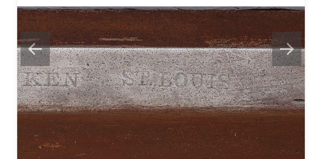

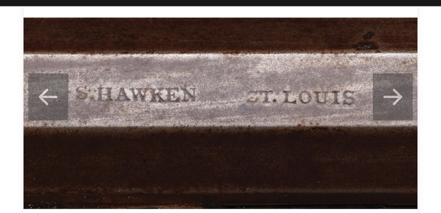

https://www.rockislandauction.com/catalog/4096 if you want to see the whole auction.
That stock looks like it has been around a long time. It’s been over-cleaned for sure. If it is a re-stock, it was done long ago during the gun’s working life. And though it’s odd that Sam would choose such a piece of wood, it’s equally odd that someone would restock a gun with that piece of wood.  Also odd that someone might change the spacing of the underlugs if re-stocking the parts.  I don’t feel certain one way or another. Is it the finest full stock S Hawken rifle I’ve seen? No.
There’s also a S Hawken squirrel rifle at that auction.
Here are the stamps.
