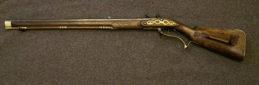

Also, if it is possible, try to examine original German rifles first hand.  I find that the 2 dimensional photos really do not convey the correct "feel" of these guns.  They are much more 3 dimensional than photos show.   Do not think of them as just a "short Kentucky".  Anyway, to show myself to be a hypocrite, here are some photos of a German rifle, Brandenburg or Berlin style.
Jim Everett

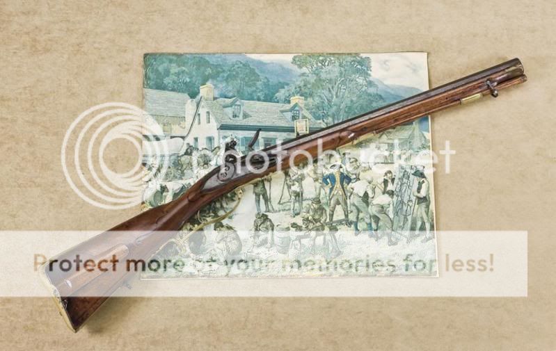

Here are a couple low res pix of a jaeger that belonged to a colonial Revolutionary War soldier from the Mohawk Valley of NY.  It belonged to a Vrooman who was an officer.  It's not clear whether he picked it up at a battlefield or it was his personal arm.
« Last Edit: July 29, 2025, 08:42:12 PM by rich pierce »

« Reply #13 on: January 13, 2012, 03:02:45 AM »
Rich,
Do you know how long the barrel is on that rifle?
Mark Thomas
The other DWS
Re: Jaegers in the Revolutionary War
« Reply #14 on: January 13, 2012, 05:25:28 AM »
looks to be about 6 times as long as the lock as a rough guestimate
  • Posts: 20841
« Reply #15 on: January 13, 2012, 06:02:30 AM »
Guessing 18", maybe 20.
« Reply #16 on: January 13, 2012, 06:17:45 AM »
Just eyeballing--it looks to be a bit less than double the LOP. Maybe 20-25"?

Rich;  That jaeger is a real beaut.  Is it in a private collection, or yours?  Are there better photos available anywhere?
  • Posts: 20841
« Reply #18 on: January 13, 2012, 10:02:37 PM »
I wish I had more info.  It came up at auction and the estimated price was higher than I could manage so I did not bid.  here is the description:
Important American associated flintlock Jaeger rifle, ca. 1740, 36” overall with a 21-1/4” barrel of approx. 68 caliber rifled, museum type plaque affixed to bottom of stock is engraved in script “No. 6 Cap.t J. Vrooman’s rifle, Recovered by his friends”; trigger guard shows an 18th or 19th century inscription which is very light and reads “Taken from Walter Butler’s Indians, 30th day of Oct’b 1781”. Rifle is in good original condition with extensive research and documentation, including duMont inventory. The Jaeger shows brown patina original finish with light to moderate erosion and pin prick pitting, wood is good with typical German styling and carving showing some breaks and small losses around top edge, but generally good overall, with simple handmade wood ramrod and in original flintlock configuration (hammer screw probably an old replacement); there is a silver plaque inlaid at the wrist which has been polished. Many handwritten letters are included which date back to the 1940’s tracing the Vrooman family and documenting the purchase by John S. duMont in the 1960’s from a relative. Tunis Vrooman was from Albany County, New York, and was a veteran of the French & Indian War, who was appointed Captain in the Albany county Militia during the Revolution in Col. Jacob Sternberger’s Albany County regiment. He was killed by Indians Aug. 9, 1780, in a raid on the Scholharie Valley by Joseph Brant. Brant killed Tunis and his wife and took his rifle, according to duMont’s notes, which he cites “Public papers of George Clinton, Vol. 6, 1902. Also according to duMont’s notes and letters, apparently the rifle was installed in the Schoharie Valley Historical society, who installed the engraved plaque on the rifle. Est.: $7,500-$15,000.
