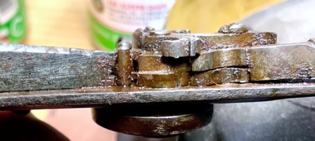

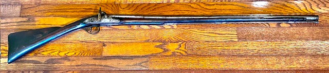

I had an opportunity to fondle an absolutely gorgeous early British fowler yesterday.  It is a new acquisition and gave me a serious case of the I wants.
It is a signed piece by Thomas Fort and reported to be built in the 1690 to 1710 timeframe.  As I recall, Fort passed away in 1713.  Please excuse the poor quality photos.  They were taken with a phone under less than ideal conditions.  It was our first peek at the lock internals and a good cleaning is obviously in order.

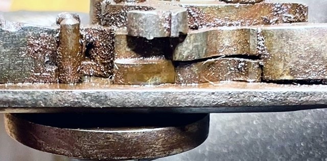

Half cock
Full cock
Take a close look at the sear/tumbler engagement.  The sear is a split affair with the half closest to the plate pivoting and apparently spring loaded.  The section closest to the plate engages the half cock notch and the other fixed section engages the full cock notch.  I have never seen a setup even remotely similar to this and am anxious to see more.  Perhaps if the owner decides to have it disassembled for cleaning .....
The owner is not a member, but I believe he intends to join, and might join in the conversation - hopefully with additional pics,

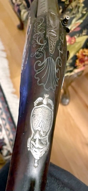

Did I mention that it has a silver side plate?

Marvelous! Thanks for sharing.
I’ll take a guess regarding the sear and tumbler configuration. I’m guessing this serves the same function as a fly and insures the sear will ride over the half cock notch when firing. I’m going to guess that the noses of the sear were brazed on.

« Reply #2 on: October 23, 2023, 05:15:57 PM »
Your date is about a half-century too early for this gun.
  • Posts: 4309
Re: Thomas Fort Fowler ca 1690-1710
« Reply #3 on: October 23, 2023, 05:37:28 PM »
Is there a signature on that somewhere?  Because as Jim says, there is no way that this piece (beautiful as it is) is that early.  Maybe there was a jr. or descendant with the same name?

« Reply #10 on: October 23, 2023, 06:35:58 PM »
Looks like a 1760-70 gun. Nice though.

« Reply #11 on: October 23, 2023, 06:37:50 PM »
I would also suspect a recycled barrel in the event there was only one man of that name.  Just off the top, the decorative wirework is straight up mid-rococo which is not late 17th/early 18th century.  Probably mid 1730s to 1740s at the earliest.  I can't get the images to open larger for me but what I can see of the lockplate also tells me mid-18th century.  Not to mention the stirrup spring/tumbler arrangement.
« Last Edit: October 23, 2023, 06:40:55 PM by Eric Kettenburg »
« Reply #12 on: October 23, 2023, 06:42:02 PM »
A british gun that early would have a round faced lock. This one has a flat lock with a step at the tail. 1770-ish. Pictures of the mounts would nail the date down.

« Reply #13 on: October 23, 2023, 07:30:51 PM »
Hi,
The split sear is called an intercepting sear.  It is designed so the inner half of the sear tip is not connected to the sear bar.  That way, if the trigger is pulled so hard at half cock that it breaks the tip off the primary sear, the separate secondary inner sear tip will hold the lock at half cock.  When the lock is pulled back to full cock, the two sear tips line up and the lock fires normally.  This was a feature seen in locks used by John Twigg during the 1770s.  This gun may have an old barrel but the rest is from the late 1760s - 1770s. The photos are not clear but the barrel profile looks archaic suggesting an old one.  I wonder if the lock has a different name on the plate.

  • Posts: 4940
« Reply #14 on: October 23, 2023, 07:59:31 PM »
That three-stage barrel is certainly of a much earlier form and atypical of what you would see on a gun with this quality level from the 1760's-1770's.  I'm with the others who suggested a re-used barrel.
As to the details that suggest a post-mid-18th century date, I would include everything but the barrel!  After you study this stuff even a little bit there won't be any question.

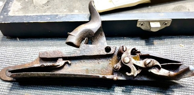

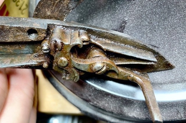

Thanks to smart dog for the information on the intercepting sear.  I do need to make one clarification.  The two sear tips do not line up at full cock - ref the full cock photo.  Each notch is approximately 1/2 the width of the tumbler face and, as I recall, the full cock notch is on a larger radius - but I might be mistaken there.

« Reply #16 on: October 23, 2023, 08:53:52 PM »
Looks like the tumbler and mainspring work together using a stirrup.

To Mikes comment regarding round vs flat faced locks:  There are examples of English flat faced locks dating to the second half of the 17th century.  The Henry Crips lock dated 1647 would be one example.  Granted, it is a dog lock but, going from memory - which can be a perilous move at my age - the plate bears some similarity to the plate on this piece.  What am I missing here?
Intercepting sear:  Could someone post a photo of, or a link to, a lock mechanism (Twigg or otherwise) that has an intercepting sear?  Although the concept might be the same, intercepting sears I have found on the net have significant mechanical differences compared to this lock.  What is the documentation regarding the first use of such an arrangement?
Spring/stirrup/bridle:  When did the stirrup first come into use and what is the supporting documentation?

Hi,
Plates 106-109 in Neal and Backs' "Great British Gunmakers 1740-1790" show all the parts of an intercepting sear used by Twigg.  Page 49 has the written description.  Flat faced locks mounted flush with the stock were common on British guns during the late 17th century but they were much more primitive mechanisms and did not have raised moldings on the edges or stirrups on the tumbler.  Many had no internal bridles and almost all had no pan bridles.  The lock on this gun was made during the late 1760s or early 1770s.  Hopefully, the owner possesses the reference I mentioned.
