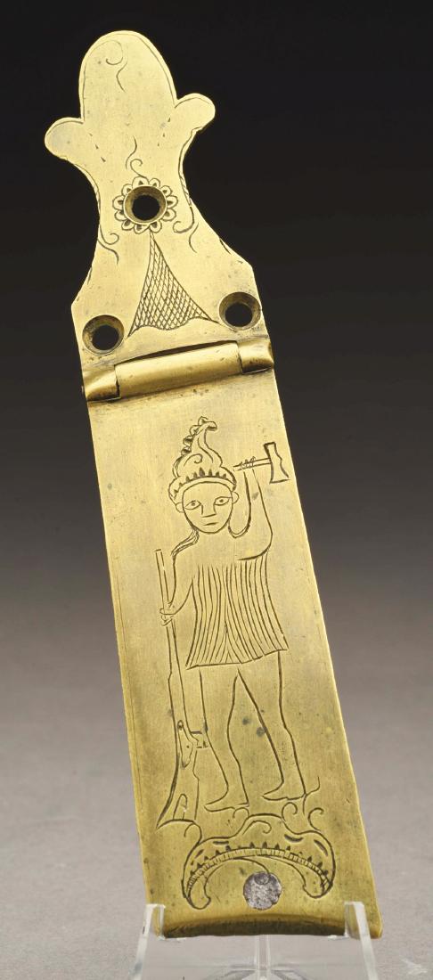

« Reply #109 on: August 15, 2018, 11:37:26 PM »
Instead of starting a whole new discussion I thought this would be a good place to add this piece into the mix:
https://www.invaluable.com/auction-lot/unique-allentown-john-moll-jr.-engraved-patchbox-fe54ce7a30
That patch box door definitely shows an Indian not a colonial lady.
  • Posts: 2621
Re: The Lehigh Indian Head
« Reply #110 on: August 16, 2018, 12:57:25 AM »
A darn good addition to the discussion!  This one is clearly an Indian.
For me, an extremely interesting discussion, and I thank you for the addition which has brought it to the front.
Whether an Indian, Lady Liberty in a Phrygian cap, or the woman serving the beer at the local hangout tavern, it is very perplexing puzzle.  Indeed, one that we may never know the correct answer to.
But - he/she/it IS going to be on the Rupp rifle I am attempting to emulate.
Many thanks, Rambling Historian, many thanks!

  • Posts: 4334
« Reply #112 on: August 16, 2018, 05:57:15 AM »
Scott - I don't see what clearly makes that an Indian.  I would say it *could* be, but it could also represent a rifleman with a 'liberty' cap and a rifle frock.  It's interesting that the rifle engraved along with the figure is indeed meant to convey a rifle given the obviousness of the box lid.  Colonial riflemen were known for carrying tomahawks also.

  • Posts: 1197
« Reply #114 on: August 16, 2018, 04:21:20 PM »
One thing to keep in mind is that Native Americans and Native American imagery became symbols of white America too, especially in the early national period.

Offline T*O*F
  • Posts: 5197
« Reply #116 on: August 16, 2018, 07:39:17 PM »
If Moll was such a master gunmaker, why does the rifle engraved on the patchbox have a patchbox engraved on the left side of a clearly right handed rifle?  Didn't he know how to engrave a cheek piece?

Offline Shreckmeister
  • Posts: 3857
« Reply #117 on: August 17, 2018, 03:07:54 AM »
Is everyone on board with the Attribution of the morphy patch box To John Moll Junior And no possibility of another maker?
Offline jdm
  • Posts: 1510
« Reply #118 on: August 17, 2018, 03:42:19 AM »
[quote author=Shreckmeister
Rob, At the bottom of the patch box lid .The engraving that looks somewhat like a weird hat. That is on a bunch of Moll patch  boxes and I do mean a bunch. I think that is where they are getting the  attribution. This box was on the cover of a K.R.A. mag. a couple of years ago along with some kind of write up.
JIM

  • Posts: 4334
« Reply #121 on: August 18, 2018, 12:06:25 AM »
Walt O'Connor's Moll box there from the auction and the KRA newsletter very definitely looks to be a John Moll Jr. product as JDM noted.  I don't doubt it at all.  Too bad it's been cut down a bit.
Scott - I will admit that my belief that the 'Lehigh Head' originated with John/Johannes Moll Sr. is largely speculation, but it does have somewhat of an origin in observable basis in that the guns which appear to be the earliest pieces utilizing some form of this 'head' are pieces which are either signed by John Moll or unsigned guns that I personally would attribute to John Moll Sr., and I'd like to think I have a pretty good handle on his work at this point.  Actually I should say the earliest appearing Moll work appears to be concurrent also with something like the Antes swivel breech which seems potentially late War-era or earlier 1780s, so we can't overlook William Antes as well.
I can understand one wanting to include in the discussion the 1772 PA Gazette posting regarding the Newcomer gun, but on the other hand, that likewise is merely a guess:  the 'figure of a manhead' could be many things and there is no way to determine whether or not it has relevance to these Lehigh pieces.  Speaking for myself, while I find the PA Gazette advertisement interesting of course, I would choose to set it outside or at the periphery of this discussion given that we have no way of knowing exactly what is being referenced.  With the Lehigh heads, we have a visual and tangible example of some type of commonality.  All of the pieces illustrating this weird 'liberty head' or 'Indian head' or whatever seem attributable to old Northampton Co and over into eastern Berks, as well as William Antes down in upper Bucks, and they all seem to take a consistent form despite the many different gunmakers that ultimately were using them; this consistency seems to hint at a common origin or common "original" form which was being copied/emulated, and also to my mind seems to indicate a common understanding of some underlying meaning.  Just speaking off the cuff for the moment, I do not ever recall seeing this representation on anything other than these regional arms ca. late 1770s/early 1780s through the early 19th century.  I would therefore tend to speculate that it must have had some form of meaning that was on the more personal side to these regional gunsmiths being as tradesmen engaged in other work in the region did not seem to feel any propensity to include it in their own work.
