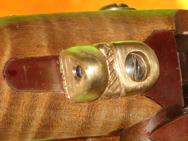

A few years ago my vision changed very quickly. In late summer I was shooting as good as ever, took 2 deer with my .54 flintlock. Then just after Christmas I got the urge to do some squirrel hunting so I checked the sights on my .40 flintlock. Instead of a good tight group my shots were all high and scattered. I could't focus on the rear sight. Later I was diagnosed with sugar diabetes and that negativly affected my shooting a great deal.
I had been thinking about a peep for some time. I wanted it to be as low to the bore as possible, but with swamped barrels that might be difficult. Anyway, this is what I came up with and I have them on both my flintlocks now. The sight has a 10-32 peg through the rear peep. I had to drill and tap a hole through the tang at an angle to keep the sight square with the front post. The hole is drilled as close to center as possible. There was also work done to the bottom of the tang and to the stock but I won't get into all that.
Like daveC2 I have been asked about making and selling the peep. Keep something in mind here,  if I provided this peep how would you mount it? How about dave's sight which is much fancier than mine. Fact is; if a person can take a finished peep and then mount it to your rifle then you have the skills to make the sight yourself.
So think about that then go and make one that suits you and your rifle perfectly.

Forced to stay home project  brass hand shaped Acorn peep
Offline recurve
  • Posts: 867
Re: Peep/tang sights back in "the day"?
« Reply #60 on: March 25, 2020, 10:30:30 PM »
I had to regulate the rear sight (filing from the base to lower groups)  seems to work shot 100yrds from bench
  • Posts: 17139
« Reply #61 on: March 26, 2020, 08:06:22 PM »
For a "shiny" aperture sight, it certainly seems to work.
Does it have a short peg fitting into a hole in the tank to prevent sideways movement?
I see it is slightly off to the right, and so is the final group, not much, but enough to correct.

I was thinking some cold blue on the brass peep would tone down the shine a little, and serve you better in the long run.  God Bless,   Marc
Offline recurve
  • Posts: 867
« Reply #63 on: March 27, 2020, 05:50:30 PM »
I was getting grouping to the left sooo I move rear sight to the right (I need to center the rear sight and drift the front sight to the left) and then mark the tang and new sight centered (or add a small allen screw) I'm rumbing it down with barrel soiled fouled patches to get the shine down

Another consideration on that brass sight, If it were mine I would make the back of it flat and not coned. I think you will get a sharper sight picture and the slope of the rear cone wont be there to reflect too much light as you look through it.
  • Posts: 17139
« Reply #66 on: March 28, 2020, 03:14:16 AM »
Yes  - smylee has a point. The rear 'face' should always be flat or have dull black stepped reductions on the surface.
All coning should be from the front surface to get the thinnest possible web.

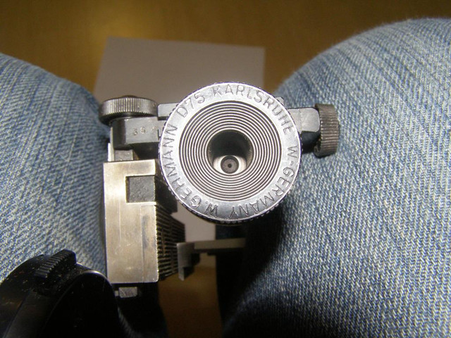

This one has an adjustable iris at the bottom of a long larger dia. tube so the aperture is always shaded.

« Reply #68 on: March 28, 2020, 09:21:35 AM »
It is an AJ Parker sight and yes, a very good one. On a 28" bl. each click is 1 moa.

Ok I took your advise, I counter sunk the opening facing the shooter flatting and darkening leaving it ruff/mat . I then took the sight off & put it in a small mound  of 4f   and flashed it instant dark patina.
I do all mine with the surface facing the shooter left flat and I countersink the opening  facing the front sight. I also paint my peeps flat black though a good browning would probably be just as good.

updated

That is better, recurve. I might add here, that a stationary store will have Dry Erase, felt pens. This gives a perfectly flat, black finish
that is easily wiped off with a finger.  It also blackens shiny front sights instead of giving them a shiny black appearance, as do
permanent felt marker pens.
The Dry Erase pen is always in my 'possibles' bag for when the front sight is too shiny on an "in the sun" target. Works perfectly. Makes
for a solid flat-black front sight - hint, hint.
